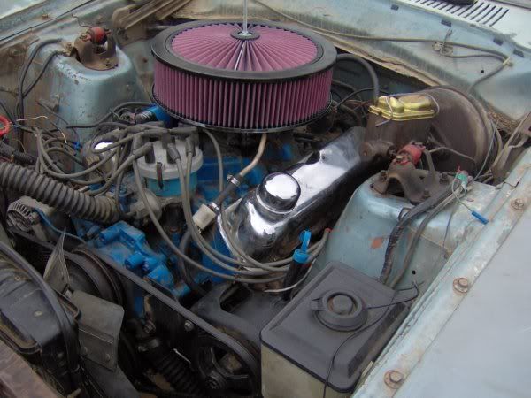

    True. Mine was a performer 289/1"spacer/holley 4160. The air cleaner had a drop base also, which was the reason why i needed the spacer. Before i had a generic 14x3 with no spacer and it cleared fine.

    Mine clears the front carb and aircleaner assembly on my 331's 3x2 setup.:thumbs2:

    The pertronix swap is just so simple and clean, that's why I was asking.. I'm going to call them and see if it fits... They only list up to 74 for the ford, I'm guessing early 74 might still be points... I have a new 74 module to use if I have to.. Also have a msd 6al box too... Just want reliable daily driving... Thanks for the feed back, keep it coming I learn more every day.....
