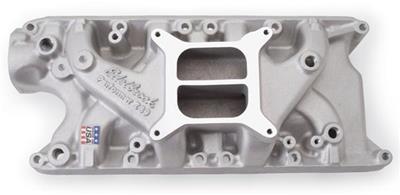

    :coco:i dont know if this will help u out the cam and intake specs:coco:
    Cam StyleHydraulic flat tappetBasic Operating RPM Range1,300-5,600Intake Duration at 050 inch Lift218Exhaust Duration at 050 inch Lift224Duration at 050 inch Lift218 int./224 exh.Advertised Intake Duration262Advertised Exhaust Duration270Advertised Duration262 int./270 exh.Intake Valve Lift with Factory Rocker Arm Ratio0.493 in.
    [​IMG]Edelbrock Performer Intake Manifolds Engine Block StyleStock/OEM standard deckCarburetor QuantitySingleIntake StyleDual planeBasic Operating RPM RangeIdle-5,500
    CARB- 600cfm 4b holley carb
