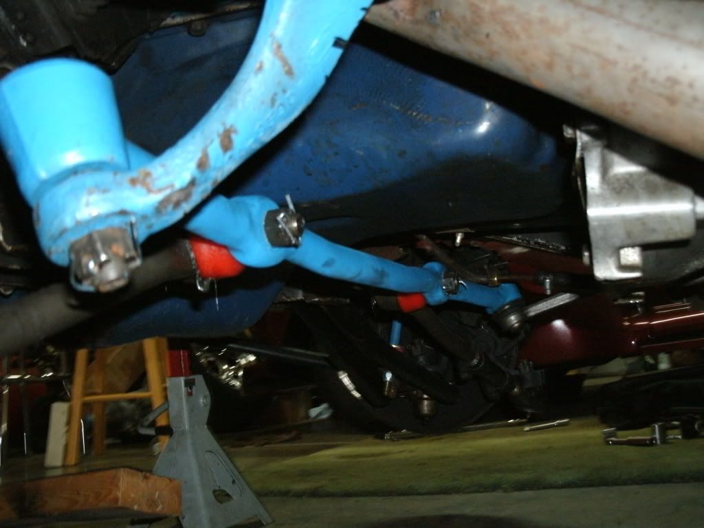

    I was just concerned about the space between the center link and the pitman arm not seating and on the steering box it is the same way.

    it looks like to me it's good...the nut looks tight and the cotter pin is in...:yup:
  5. mercgt73
    There should be a gap. Otherwise your puller would not fit to remove it. Also the pitman needs to rotate against the centerlink, if the faces mated then that would be quite a friction point. The stud is tapered, so as long as it tightened up, you should be good.
