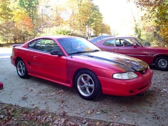

    well that maaco job on that mustang is pretty sweet. It looks great. Did you guys do a lot of the prep work? was it a repaint?
  4. rayzorsharp
    All Maaco jobs are repaints

    This is what the car looked like prior to repaint. The body was pretty straight to begin with, only thin I really did was replace the front fenders and hood because the car had been in a couple of minor fender benders. Other then that it was just some filling and sanding some little dings here and there, and then we dropped it off at Maaco. It may have helped that the shop that did it had been open for many years, and their certification was running out. They used this car to be inspected to renew their certification, so it wouldn't surprise me if they went a little beyond what they usually would on it to make sure it was right.
