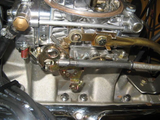

    I'm not sure what to do for the kick down linkage. The carb has the lever for it, but it connects at half throttle. I dont know how to correct that connection. Any input?

    can of worms # 2025..I ran mine without one for years...it just downshifts the transmission, I did this myself when passing or any other time I wanted to get on it hard.

    On most older trannys the kick down linkage adjusts at wide open throttle use thread sealant on the plugs or on any bolt that passes through a water passage

    Yep...thats exactly what I need! Thanks KC...
