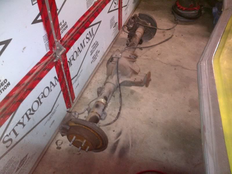

    I am fixing to do this swap i will take pictures and maybe do a tech article on it when i'm done.
    i happened into a whole v8 explorer for $650 so i couldn't pass it up
    and i have made most of my money back off of it selling off body parts off of it

    Well it is in
    but I had the housing narrowed
    guy that owes the drag strip here did it for $150
    & put my new bearing kit in it
    I'm still workin on doing the tech article
    but if you have any questions i"d be glad to answer them

  14. maver88
    maver88 Nick Taurone
    Jun 1, 2011
    166
    30
    93
    Russellville, AR
    1972 Ford Maverick 2-door & 1996 Ford F150 4wd w/ 429ci/granny low 4spd
    I was gonna attempt it myself but I talked to my old boss and he had explorer 8.8 narrowed to go under a S10 blazer w/350 in it and the guy only charged him $150, so I talked to him the next time I was at the drag strip and he said he would do mine for the same price.
    I took all the measurements of my factory 8" when I got my new wheels & tires in(15x10 4.5bs 265/50R15) & from wheel flange to wheel flange it needed to come in 1" & thats what I told him to narrow it to.
    He welded the tubes to the housing, welded spring perches on with extra bracing, new 9" torino style ends(I bought $60), & installed all new bearings($35 kit) for $150. All I had to do is paint it & order custom axles from Strange at $450 with wheel bearings & studs & spacers included.
    After it was narrowed all you have to do to get axles from strange is to fill out their form and call it in with a credit card.
    I still have my form with all the measerments of the newly narrowed housing, might scan it on here if u guys want me to
